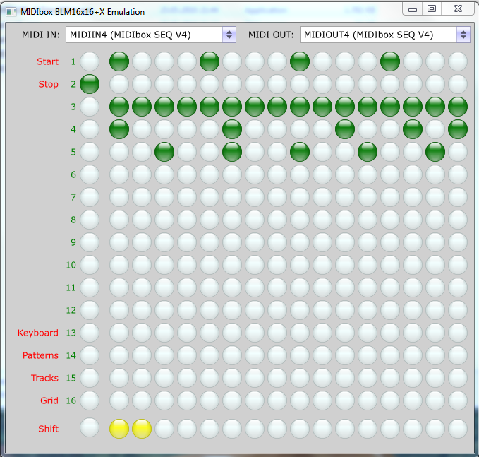

Gridracer Posted May 30, 2010 Report Posted May 30, 2010 Sorry to disturb again, but I noticed anotehr issue with beta22 and the 4x16BLM: onyl on step 1-16 the LEDs for active steps get lit, on step pages 17-32 and higher the LEDs stay off whether the step is active or not. Chaselight and buttons work correct, also the GP LEDs Best Regards, Gridracer Quote
TK. Posted May 30, 2010 Author Report Posted May 30, 2010 I will check this soon! Best Regards, Thorsten. Quote
