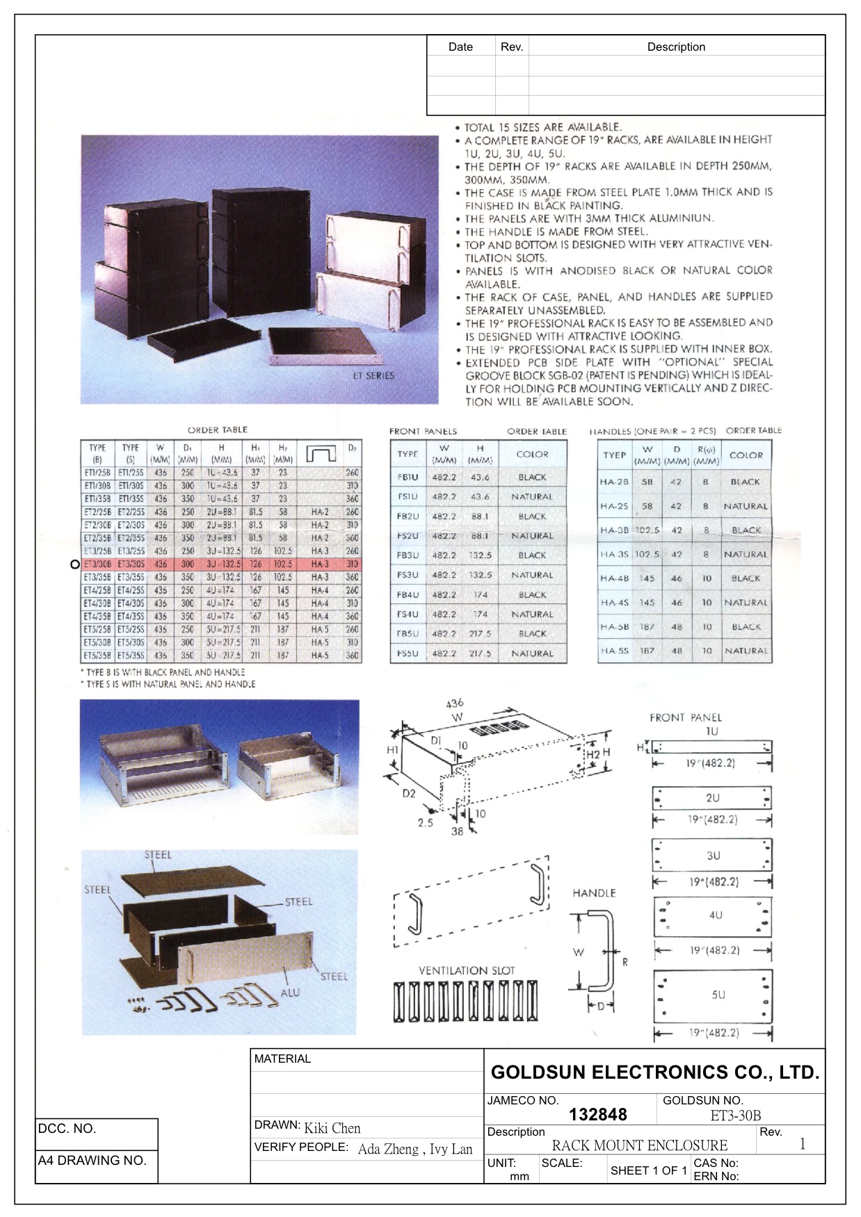

m00dawg Posted January 5, 2011 Author Posted January 5, 2011 Found a few places to get 3U enclosures: http://www.par-metal.com/product-rmc-10series.php There is an eBay store that sells them as well; http://stores.ebay.com.sg:80/Antek-inc/_i.html?_fsub=5 Keep in mind, the default 19" rack template in Front Panel Express has the handle-mount holes in different places. I have e-mailed par-metal to get exact dimensions (I could not easily read them off the low resolution diagrams they had on their website). They are a bit pricey but I think otherwise should do the trick.
Altitude Posted January 5, 2011 Posted January 5, 2011 Jameco has some reasonably priced racks: http://www.jameco.com/webapp/wcs/stores/servlet/StoreCatalogDrillDownView?langId=-1&storeId=10001&catalogId=10001&freeText=rack%20enclosures&search_type=jamecoall
m00dawg Posted January 5, 2011 Author Posted January 5, 2011 Ah yeah good point. Sent them an e-mail to see if they can provide some measurements and overall specs. Otherwise a good find!
m00dawg Posted January 6, 2011 Author Posted January 6, 2011 Jameco responded and said that, though it may take a few days, they should be able to provide the dimensions. Sounds promising!
m00dawg Posted January 8, 2011 Author Posted January 8, 2011 Got the specs back. Attached. They are sort of low res so I'm having a hard time reading the most important ones (at least for me) - the mounting hole locations on the front panel. Otherwise it looks like the ones form Jameco will work out great. Going to ask them for a sharper image just to see if I can get my hands on one. I'm also now debating on 3U or 4U since I will want to put in some hot SSM action. I think a 3U would work as long as I lay things out well. *shrug*
m00dawg Posted January 8, 2011 Author Posted January 8, 2011 No better scans so it looks like that's going to have to do. It's definitely different from the hole panels on the default 3U rack layout in FPD. I can't really tell from those scans where the holes are though so I guess I'll have to measure it myself when I buy one.
