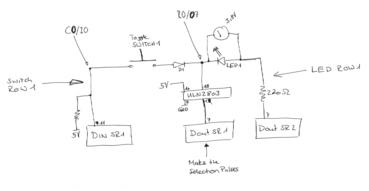

novski Posted September 15, 2013 Posted September 15, 2013 Hi I made my self a breadboard test of a Button and LED Matrix. Im not able to make it work as i wish. So i ask for a sample config of a 8x8 button_matrix with a 8x8 LED_Matrix wich for testing wold lit the LED 1 by pressing Button 1 and turn it of by depressing the same button. button_matrix sr_din1=1 sr_dout1=1 LED_matrix sr_dout1=2 sr_dout2=3 best regards novski
TK. Posted September 15, 2013 Author Posted September 15, 2013 This is the most simple example: http://svnmios.midibox.org/filedetails.php?repname=svn.mios32&path=%2Ftrunk%2Fapps%2Fcontrollers%2Fmidibox_ng_v1%2Fcfg%2Ftests%2Fblm8x8.ngc For your HW connections, you've to change the DIN/DOUT matrix configuration to: DIN_MATRIX n= 1 rows=8 inverted_sel=0 sr_dout_sel1=1 sr_din1=1 DOUT_MATRIX n= 1 rows=8 inverted_sel=0 sr_dout_sel1=2 sr_dout_r1=3 Best Regards, Thorsten.
novski Posted September 16, 2013 Posted September 16, 2013 (edited) Thanks. Now it works. I had a LED the wrong way and used the DINx4 with 220R also in the Selector lines - sr_dout_sel1=1 (...) The Link mentions just 3 SRs. Thats why i tried to build a better version than i had working. # HW definitions: DIN_MATRIX n= 1 rows=8 inverted_sel=0 sr_dout_sel1=1 sr_din1=1 DOUT_MATRIX n= 1 rows=8 inverted_sel=0 sr_dout_sel1=1 sr_dout_r1=2 # note: actually the sr_dout_sel1 in DOUT_MATRIX could be removed, # since DIN_MATRIX already outputs the selection pulses there # this is just for the case that somebody copy&pastes the definition... I layouted it like on this schematic: It seams to work but: The LED seams to be not as bright as it can be. Am i doing that right? Best Regards novski Edited September 17, 2013 by novski
