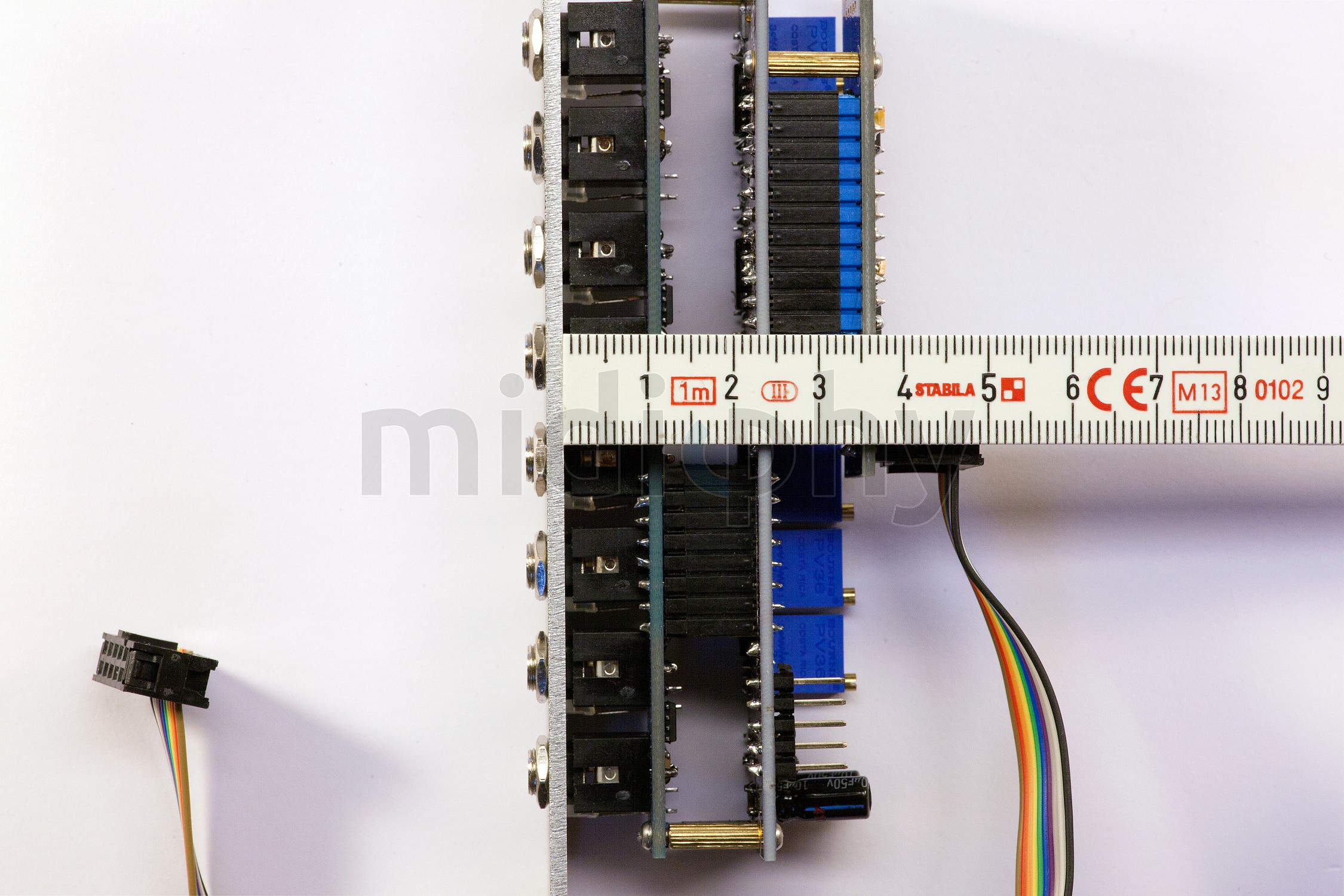

lukas412 Posted August 10, 2019 Posted August 10, 2019 This looks sooo cool! Thank you! Any idea on depth of the modules?
Hawkeye Posted August 10, 2019 Posted August 10, 2019 Thanks, @lukas412! :) Just measured this quickly and took a photo, as i am sure others will have the same question: The photo is of the new triple-PCB sandwich "A1 Expander" (8x CV out), which has the highest depth of these modules. You should be good with a 50mm deep case, the module just fits nicely in my Moog 104HP skiff despite its "max depth: 48mm" specs :). Of course all kudos for these modules fly out to Andy! Have a great weekend and many greets! Peter
jaytee Posted August 10, 2019 Posted August 10, 2019 Amaaaaazing! I’m on vacation atm but I will probably order these boards as soon as I get back. Is there any chance I could convince y’all to release the design files—or even just a super basic drilling guide—for the panels? I have the means to DIY my own panels and some kind of official measurements would make the job quite a bit easier.
latigid on Posted August 10, 2019 Author Posted August 10, 2019 Maybe we should have a new thread for module things? Regarding depth, note that it would be doable to squeeze things tighter with shorter headers or even direct soldering. Right-angled IDC headers would also help. For panel files, at least at the beginning I prefer to keep them closed. We might offer different colours in the future (e.g. black panels). But if you really would like to do your own, just put a note in when you order and I can give you the dimensions. It wouldn't be difficult to measure either :).
