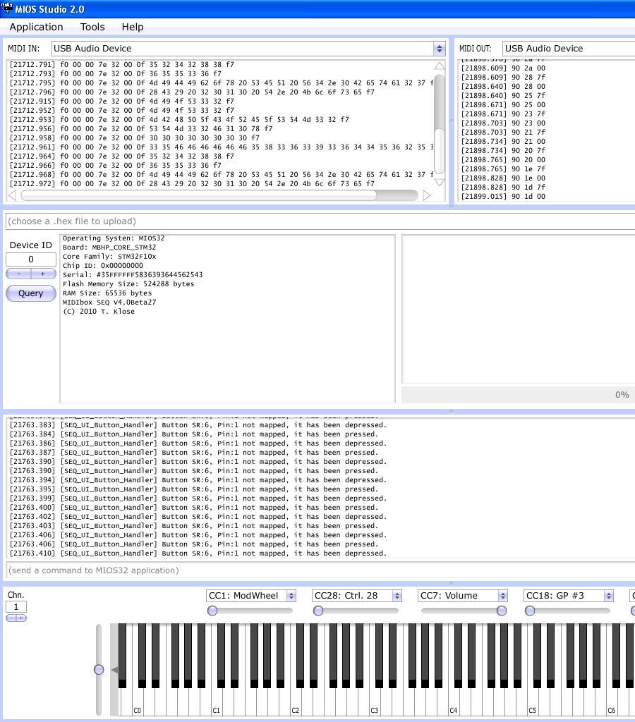

Echopraxia Posted September 24, 2010 Posted September 24, 2010 (edited) The terminal shows that something is wrong with the sequencer. I attached a picture of what its doing. It is pressing and depressing button SR:6 pin:1 very rapidly as soon as MIOS is loaded. Is this encoder #5 or F1 button? Maybe this explains why sessions quickly switch back to the "last one"? I guess I should move this conversation to trouble shooting now. I did format the sd card and put the files back on it but still received the same errors. I also ran error checking (vista) and it found some error and said it fixed it but that didn't help my situation. FAT32 is the way to go yes? Edited September 24, 2010 by Echopraxia
TK. Posted September 24, 2010 Author Posted September 24, 2010 I guess that you are using Wilba's frontpanel? If SR6 toggles, it means that the last DIN SR has no pull-up at pin #10 (SER) Check that all resistor (arrays) are mounted and properly soldered! SD Card: please type "sdcard" into the MIOS terminal and copy&paste the output into this article. Note that by right-clicking on the terminal window you can copy the content (no need to make snapshots) MBSEQ supports FAT8, FAT16 and FAT32 And another hint: type "help" to get a list of some other helpful commands. Best Regards, Thorsten.
