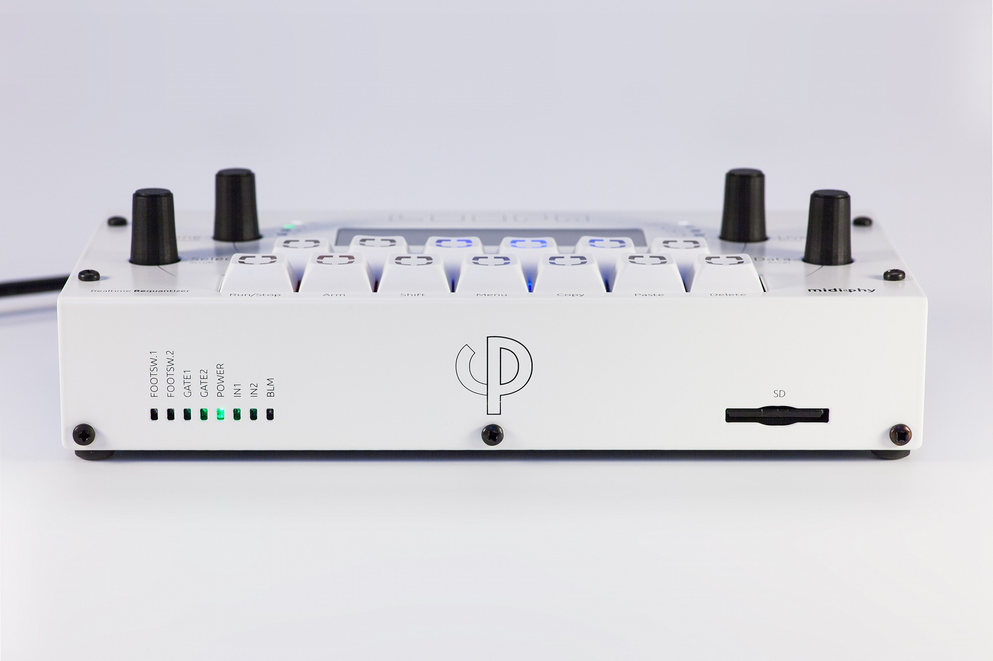

Hawkeye Posted March 28, 2020 Author Posted March 28, 2020 The metal case LoopA kits are now available - fantastic work by Adrian from Hallik Engineering! :-) Also, this kind of reveals the new "2020 facelift" keycap style :) https://www.midiphy.com/en/shop-details/0/71 Hope you enjoy! :) Please stay safe! Many greets, Peter
