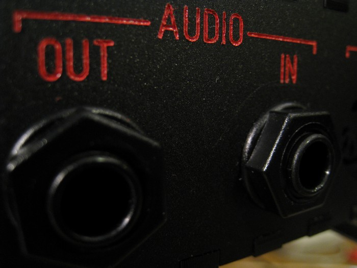

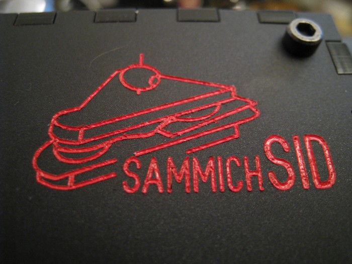

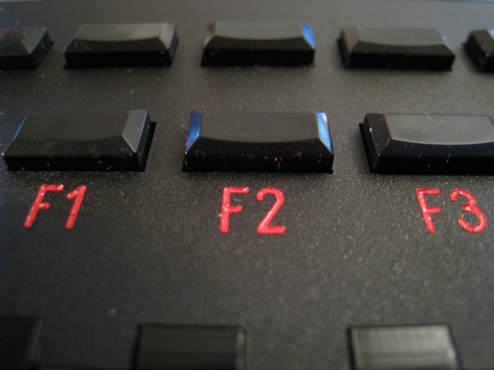

Wilba Posted November 28, 2010 Author Posted November 28, 2010 After seeing Seimpre La Luna's painting, I decided it was time to give enamel paint a try, and I am so much happier with the result. I have perfected the technique, I think. I use a 5mm x 15mm piece of thin flexible plastic, cut from the clear plastic that you find in packaging. I use this piece of plastic a a mini-squeegee. Just like silk-screening, I use the squeegee to wipe off excess paint. Here's the step-by-step guide: 1. Use a good enamel paint. I'm using Tamiya Gloss White (X-2) 2. Apply paint to the engraving so it fills up to the backing paper. Do one word or about five letters at a time. 3. Remove excess paint using the squeegee. Use firm pressure, but avoid scraping off isolated pieces of mask, like inside "A" and "P". Scrape off in two directions. 4. Leave to dry at least one hour. The paint should have lowered into the engraving. 5. Do a second coat (repeat steps 2 and 3). 6. Leave to dry overnight! (I guess 6-8 hours would be enough). 7. Peel off mask. Paint should not be stringy, and the mask should not pull paint out of the engraving. It only takes two coats of enamel paint to give a solid fill, and still be lower than the top surface of the acrylic. Wiping off the excess using the squeegee means you can fill the engraving to the top... my previous method of using a paper towel to remove excess paint would soak up the paint in the engraving and require more coats. POIDH? Here you go. Note the triangle inside the "A" of "SAMMICH" came off during the squeegee phase... this was fixed with a craft knife, and I could touch up the black line to the right... but I won't bother. It looks better in real life - the camera picks up every spot of dust and paint flecks.
Siempre La Luna Posted November 29, 2010 Posted November 29, 2010 That looks great! I contemplated going squeegee style on my girlfriend's Sammich but I was really worried about pulling off the mask and making a giant mess. I'm glad to know it's a viable option. Great work. Also, :frantics: sammichFM :frantics:
Wilba Posted November 29, 2010 Author Posted November 29, 2010 I pulled off another triangle in an "A" doing the kaffeSEQ case... but this is actually easy to fix, just scrape off paint after it is tack dry. I also wasn't so vigorous with the squeegee on the kaffeSEQ panels, and it doesn't cause any problems, i.e. lots of thinned paint around an engraving is OK, mask peels off cleanly. I think the most important thing to remember is leaving the paint to dry fully before peeling off the mask, or you end up with smudges, strings like melted cheese, lifting or pulling out paint from the engraving, etc. BTW I did a sample using red but it came out too dark. How did you get the red so bright? What brand of paint are you using?
