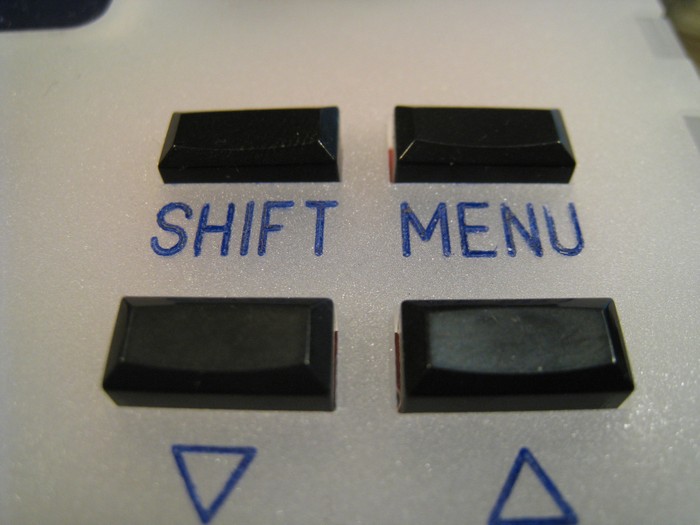

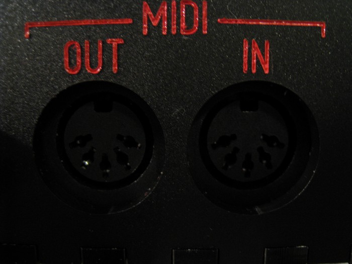

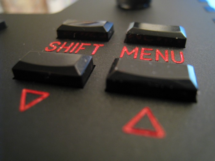

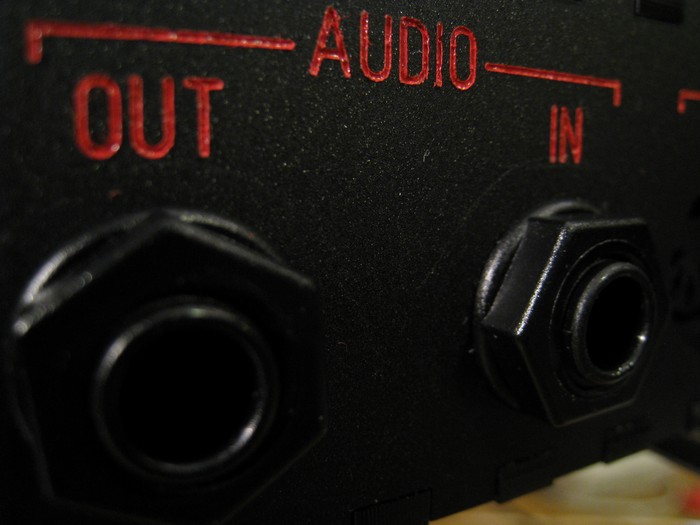

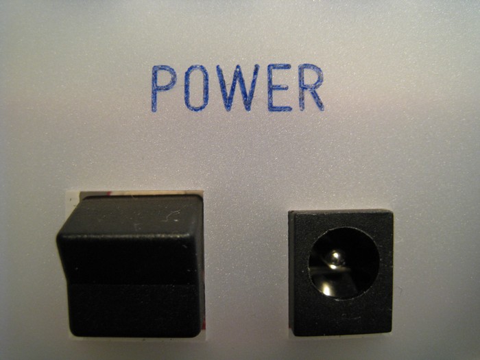

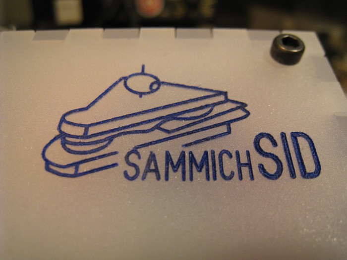

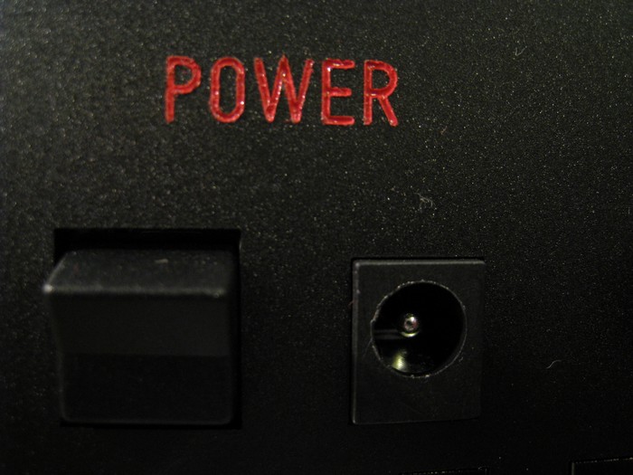

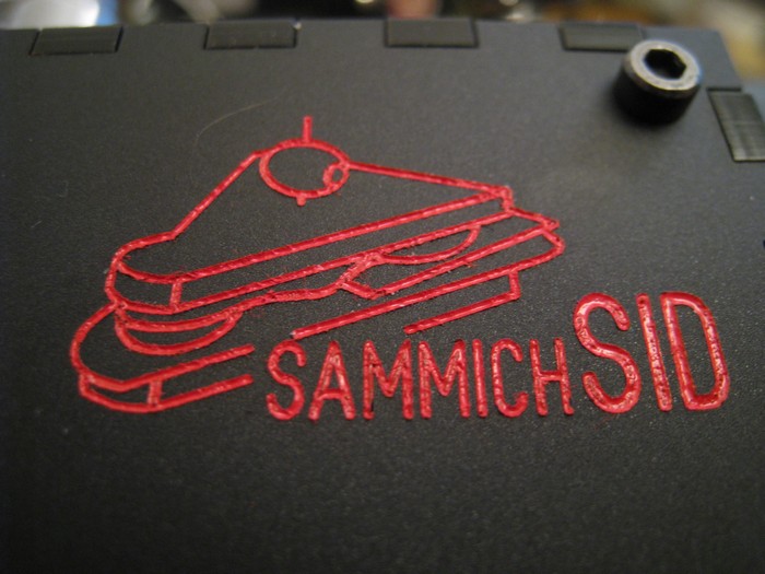

Wilba Posted November 29, 2010 Author Report Posted November 29, 2010 Based on his other post, he used acrylic on the Arctic Ice case. I think you'll get better results with enamel paint. BTW my experience differs slightly though... the Tamiya is quite liquid out of the bottle... yet very dense with pigment. Two coats is all you need, if you fill up the engraving two times and squeegee away the excess... since both coats are thin, after drying it will sink down into the engraving. Thick coats won't sink down so much, and will stick to the mask, and the edges won't be as clean. SRSLY the results I'm getting with enamel put my original acrylic paint filling to shame, and I'm a bit embarrassed it's taken me over a year to try out other paints and techniques. I hope there aren't too many messed up sammichSID panels due to my negligence. :whistle: P.S. kaffeSEQ will be available in Arctic Ice. It's amusing that people want kaffeSEQ when hardly anyone knows what it does, including me! The design brief was "make something better than Gorf". Maybe that was nILS' idea or maybe I just told him it had to be better than Gorf if we wanted me to sell kits. I forget. I used my powers of persuasion on nILS to tweak his design and make it more "kit-friendly", but I have NFI how to use it. Maybe once upon a time I did, way back when I made that proto which is just a bit of veroboard stuck on top of a sammichSID base. It's been a while since then. It has steps and stuff. It uses sammichSID-style bits. It fits together. I came up with the name, though... and if you like how cool it looks, that's all my idea, please send kudos and cash to Jason.S.Williams@gmail.com but SRSLY don't ask me what it does. Quote
Siempre La Luna Posted November 29, 2010 Report Posted November 29, 2010 (edited) That's correct. The Arctic Ice Sammich was painted with acrylic. It took forever and didn't really fill the engravings in a particularly awesome fashion, but the color is nice. Here go a few photos that show the difference. Enamel is the way to go. All we need to figure out now is how well an enamel paint marker works. Who's going to be the first brave soul to give that a try? ****EDIT*** I used three coats of enamel on the black Sammich. Two would have been plenty had I spent a few minutes really cleaning out the engraving before I started and spent less time wiping away excess paint with a paper towel. Edited November 30, 2010 by Siempre La Luna Quote
