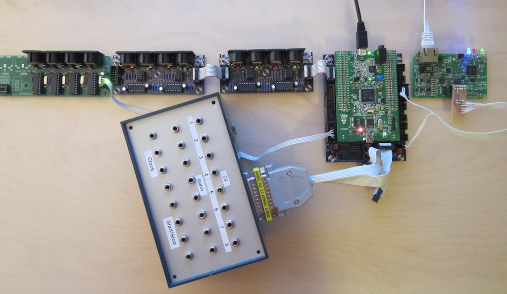

TK. Posted January 15, 2014 Report Posted January 15, 2014 A connectivity example for the upcoming MBHP_CORE_STM32F4, two MBHP_MIDI_IO, Quad-IIC MIDI, MBHP_AOUT_NG and KissBox OEM board: Best Regards, Thorsten. Quote
