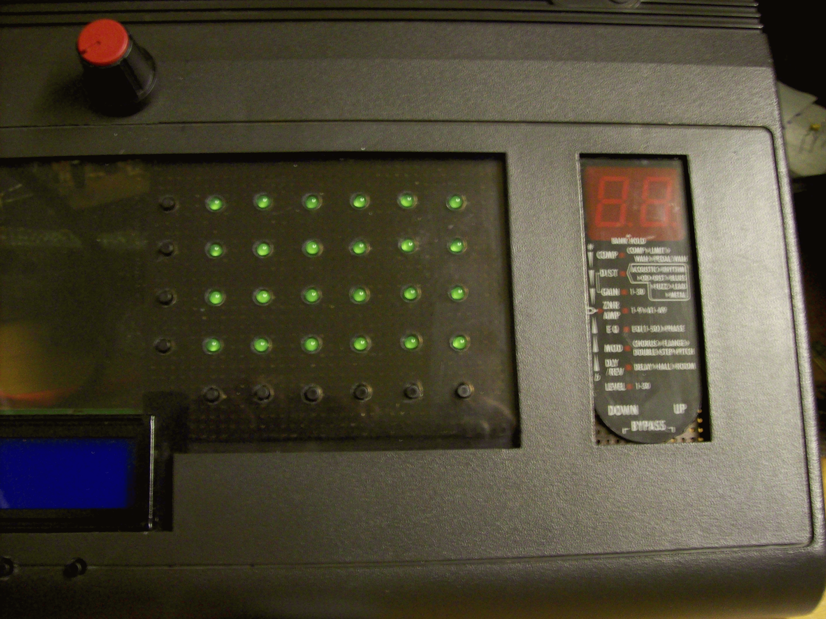

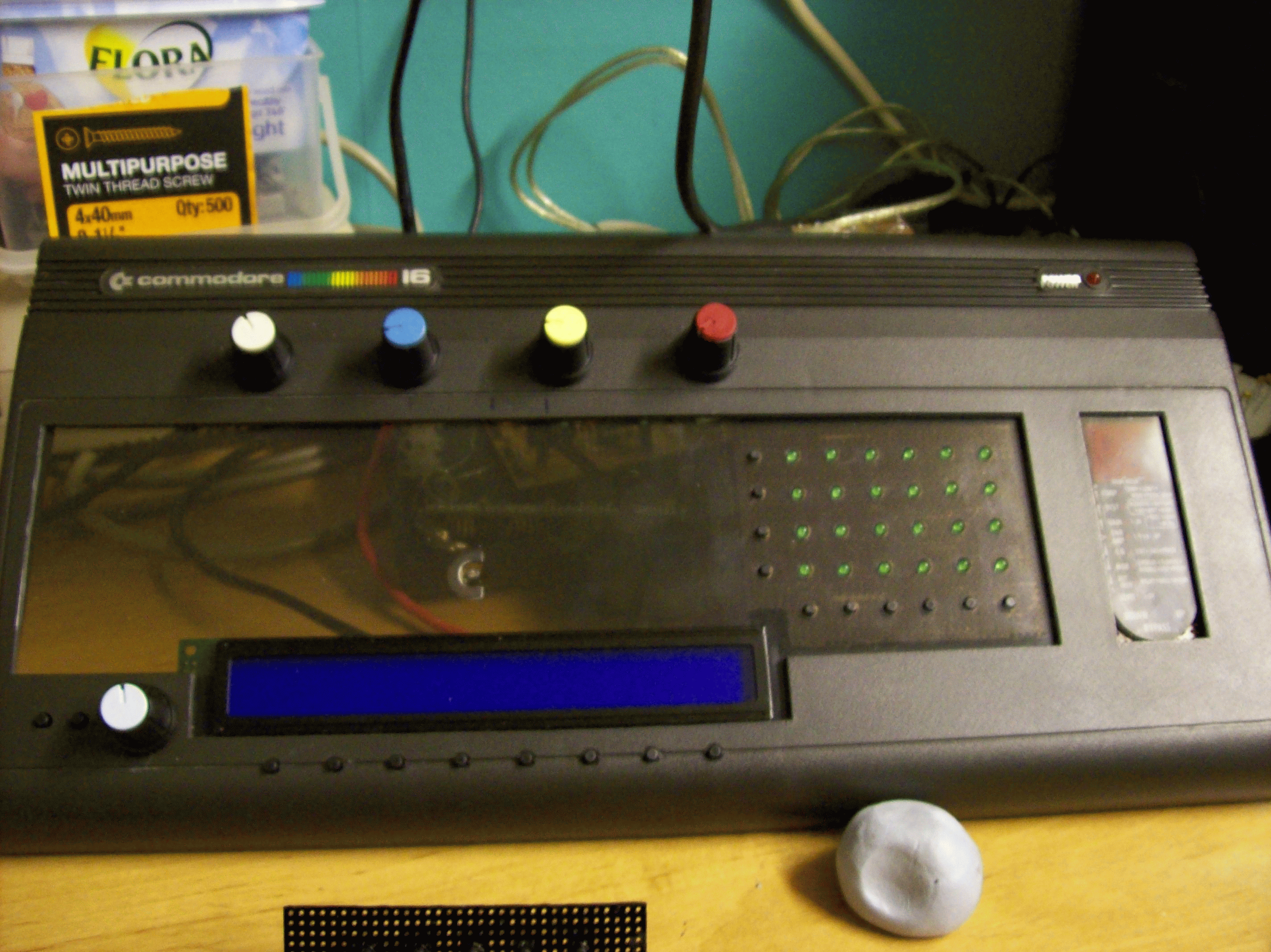

Flemming, I put the pix here for you of where I am at right now. Regarding your mbfm...have you tried swearing a lot and kicking the dog? It might not get it working but you will feel a lot better...lol. just keep at it Flemming you will get it working I'm sure. cheers Paul PS I just realised the pix are shite....oh well
