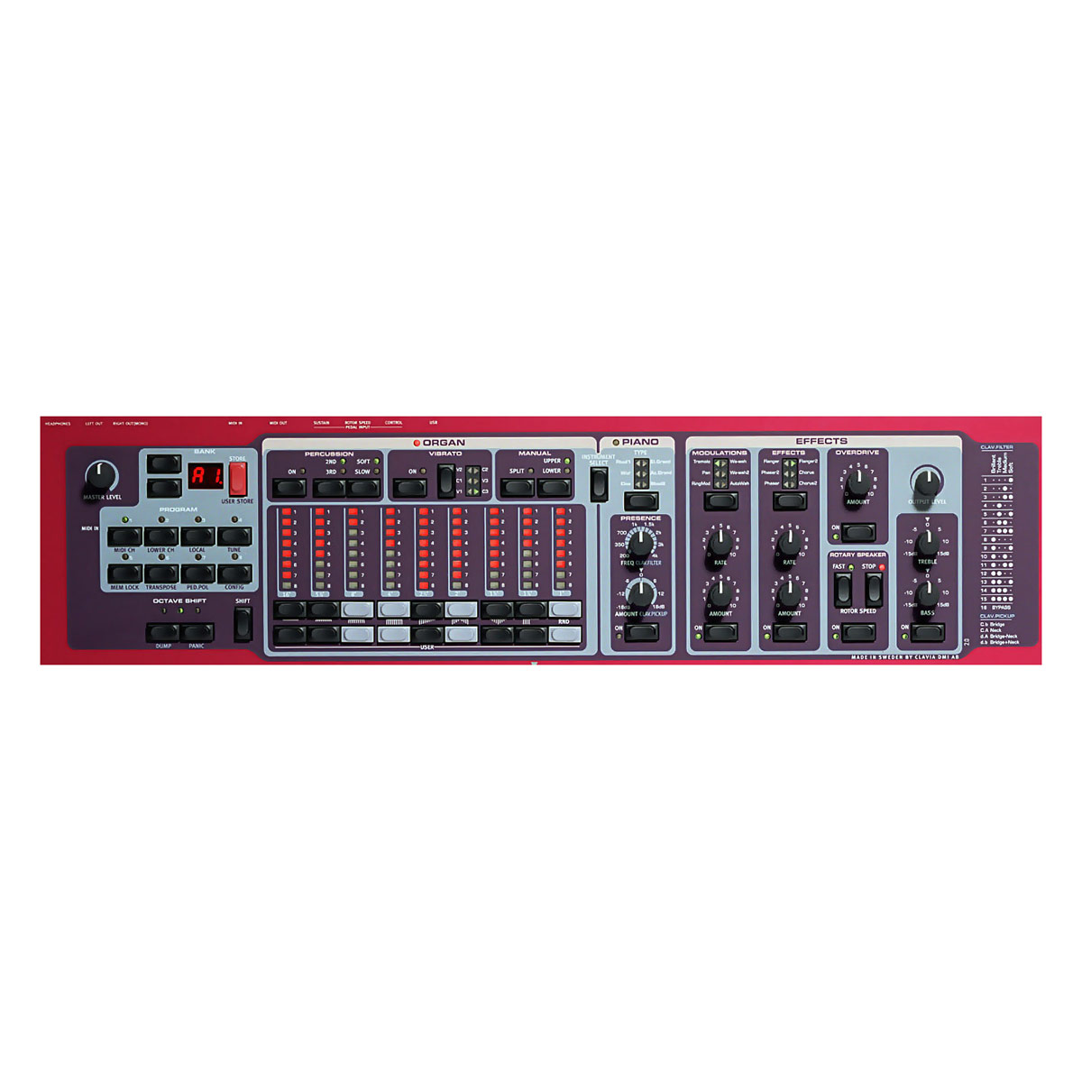

/tilted/ Posted October 17, 2008 Report Posted October 17, 2008 But OK, If Ledrings with 32 LEDs or so will be supportet...the resulution is big enough ;D ---like on the nord---led bars and Encoders (or switches) under it.....but more leds---to show the note of the step ;DRe the Nord photo...what if each button pair had two rows of LEDs? perhaps one row for 'octave' and another row for 'note'...In this case, you could probably do the whole thing with 2 rows of 8 LEDs. -I'd suggest the 'note' row be duo LEDs, so you can have sharps, too...This is kinda not software wishlist stuff anymore. This could perhaps be integrated into an external controller.
Phattline Posted October 17, 2008 Report Posted October 17, 2008 ---that was a idea---not a wish ;) ---ok a secret wish---my officell wish is a function to mix the midisequences via faders or rotarys....yes of course it is a-hardware adaption---but it requires---a stoftware.......I am also for a LED-Matrix--- (like on the sid---only bigger---and instead of only one button under it--two buttons----i am thinking of 32x32 LEDs) that can show and- edit- Poly sequences.And maybe a Pipe-organ---"chorder" function would be cool too (like on the photo) ;D....of course---adittional hardware would be requierd....I write only ideas... if it is possible or not- ??? - hardware would be requierd...-ok----but it could be integratet (or the Midi-CC for external controller could be given) in the software :) -because I dont think with a controller you can now edit your SEQv3,3 with visable chord functions and show the poly notes in a LED matrix???? and Edit it in this matrix??? this is a softwarewish too ;)(btw---read my other messages too--- and you will understand it is not only done with a simple external controller!)
Jack Posted October 17, 2008 Report Posted October 17, 2008 Hi,We could use the ring as bar. Or a Bar as ring. ;D@PhattlineHow about the Stribe instead of a Motorfader?Best regardsJack
