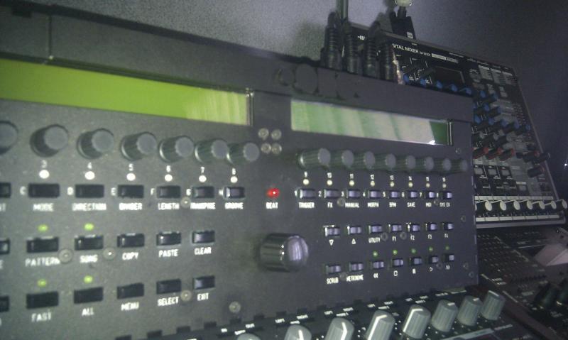

Arkay Posted January 11, 2013 Posted January 11, 2013 (edited) Just a few ideas for someone looking at doing one of these too. There's some ways you could modify the design. These are my observations from having also done a ponoko case from smokestackproductions original design in this thread (many thanks to him for the original idea/design work!): 1. As mentioned the case holes on the bottom should be mirrored. Depending on how you want to assemble your case you could go with no holes on the bottom at all and drill your own as you need them. (explained more in a minute). 2. The case may not need to be as high as in the original design. Depending on how you assemble it. 3. Adding additional holes for 4 more midi in/out's BLM is as easy as cut/pasting the original holes in the diagram. 4. I also moved my SD card slot to the far lower left side at the back and used an ebay SD card module on 10mm spacers (at it's rear), with the front of the module poking slightly through the case slot to keep it in place. I found when assembling mine that it was far simpler to attach the top panel only to the control surface, there was no need to use long screws and spacers from the top of the case all the way through to the holes in the bottom. The panel mounted directly to the control surface is very rigid and sits on top of the sides. With only 4 external nuts holding the panel/CS substrate to the sides the entire assembly is more than rigid enough. Doing this prevents having to try and line up a myriad of long bolts right through the case and makes assembly much easier, also providing more internally usable space in the case. It was nice to not have to mess with JB Weld for the panel mounting with this solution. My second point is that you could potentially take about an inch off the height of the case. If you chose to mount the core board to the base (not on 10mm standoffs), and move the corresponding midi in/out/lan/USB holes down to suit you could use as little as a thin washer to space the board from the plastic. Saving a lot in height. Equally the height of the panel/control surface board is only about 15mm when assembled, and can rest only mm's above the core and/or IIC boards if you install them. So the entire case can be much more svelt. I'd say 15mm for core board/case bottom (depending on how flat you mount the caps)+5mm clearance + 20mm CS/top == 40mm in height for the whole case. The current design is 65mm high. You'd have to calculate what is required in all measurements to achieve this but without threading bolts through 50mm spacers (x2), from top to bottom of case there is also no need for all the holes on the bottom and you can simply drill the few you need in the correct place to mount the core etc and attach the top panel to the bottom (in 6 places, each corner and 1 either side center) so that the entire case holds together. Those 6 holes in the original design already line up. So you could keep the outter 6 holes in the design on the base, and remove all others so you'd only need to drill the mounting holes for the circuit boards. Anyone attempting this case should also note that the plastic around the lcd holes is the weakest part of the design. I accidentally cracked mine by overtightening the screws that hold the top to the bottom. They should only be tightened enough to hold the structure together via friction. The space between the two lcds and the place on the right from lcd to edge are the weakest points. Fortunately I was able to glue mine back and I used some of the off-cut plastic from ponoko to make a design above the lcd's to cover the mistakes (not ideal but saved me reordering a new panel). Note that there's nothing at all wrong with smokestackdesigns original plans in this thread (apart from the mirroring of the holes). I just thought I'd throw in some options and ideas that I learned from having done one myself. They may or may not be useful to others. It was an easy process. I modified the original files in inkscape, created an account on ponoko, uploaded the design, selected the largest acrylic sheet ( No 3 size at 790mm). They cut it and sent it to me for $70. I then painted the text while the paper overlay was still in place. Cheers, Arkay. P.S. Some pics attached (taken on my phone), that give a good idea of what to expect with the finished product. I'll be putting a larger DK38 knob on the center encoder when I get one (purely for aesthetic reasons). Edited February 8, 2013 by Arkay
braintentacle Posted March 13, 2013 Posted March 13, 2013 I just got my case and it looks awesome. Thanks again Smokestack. What kind of paint are you guys using on your cases?
Arkay Posted March 13, 2013 Posted March 13, 2013 I used a small bottle of model paint from a model aeroplane shop. There is also a thread on how to do infill with wax crayons and a heat gun. That might be something to look into though you'd need to be careful with the heat gun and plastic. The paint worked ok and if I did it again I'm sure I could get a much better job due to the first time experience gained. I think this is what I used: http://www.modelkitsonline.com.au/pages/main/dataAccess.php?Key=2499 It's very difficult to paint into the cut-outs, better to dab over and fill the crevices, wiping excess around the cut-out away with a cloth, wait for them to dry a little, then repeat, each time buiilding up another layer of paint in the infill. The more you do and the more patient you are during this step the better it will turn out, aim to fill the lines so they are mostly full but still have a dip and are not completely flat (or sitting above the level of paper). I also removed the paper very slowly and carefully from mine not long after the final paint run was done as I wanted the paint partially wet so there was no chance the paper would pull dried paint out of the infill. I then used a fine blade to clean away any excess paint and the inside of cut-out letters (like the triangle at the top of an A or the inside of a D for example). It comes out pretty good done this way. Just take your time. Any mistakes can be cleaned away with mineral turps without damage to the plastic though white paint on a black matt surface will not completely clear away and a light hazy residue can sometimes remain. Good luck with it. Be sure to post up some photo's of the finished product :) Mine has been working great and my parts for my other 4 midi outs are now on their way too. Wish I'd have build them in to start with as I don't really want to disassemble it but I need to ports so don't have a choice. Cheers, Arkay.
