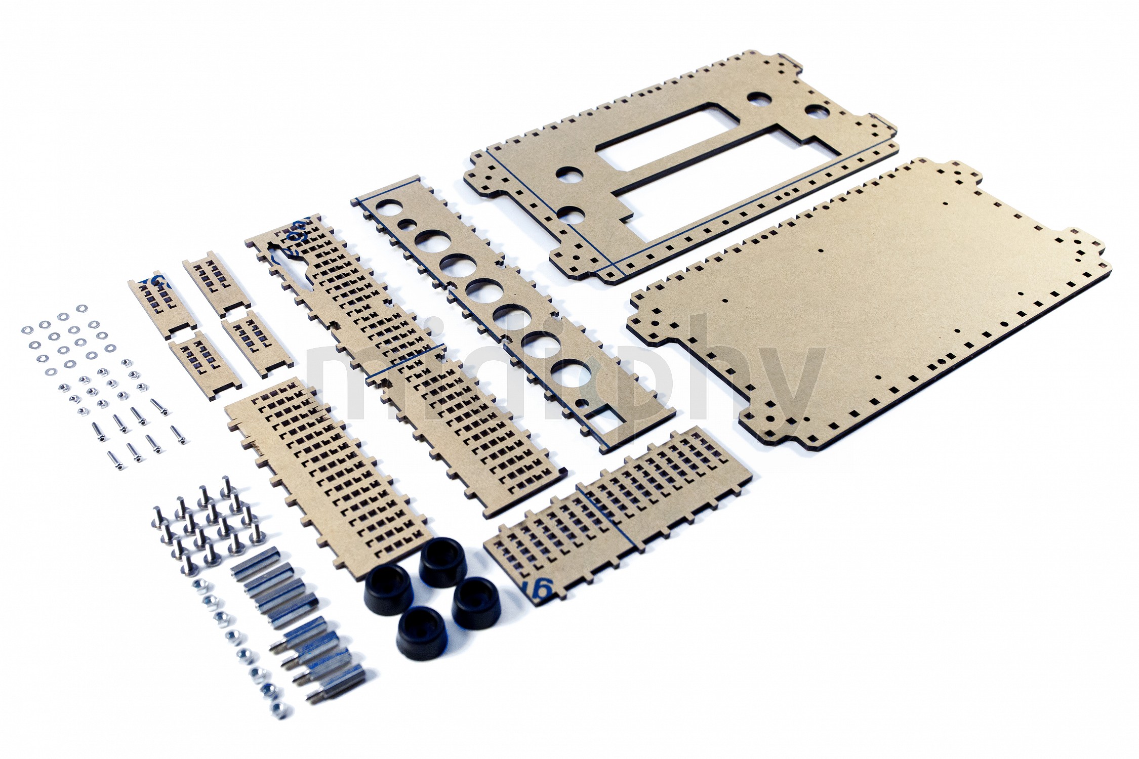

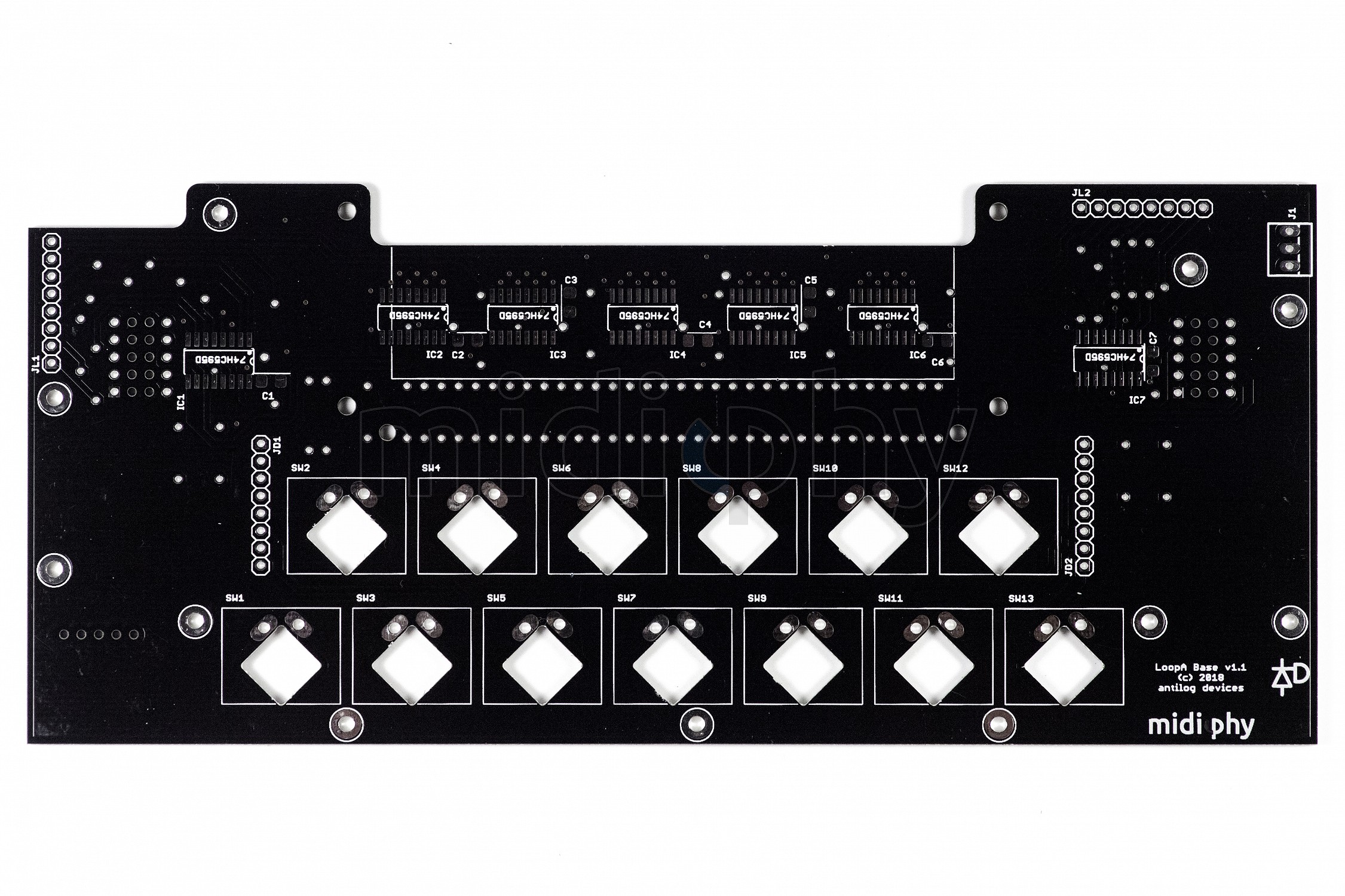

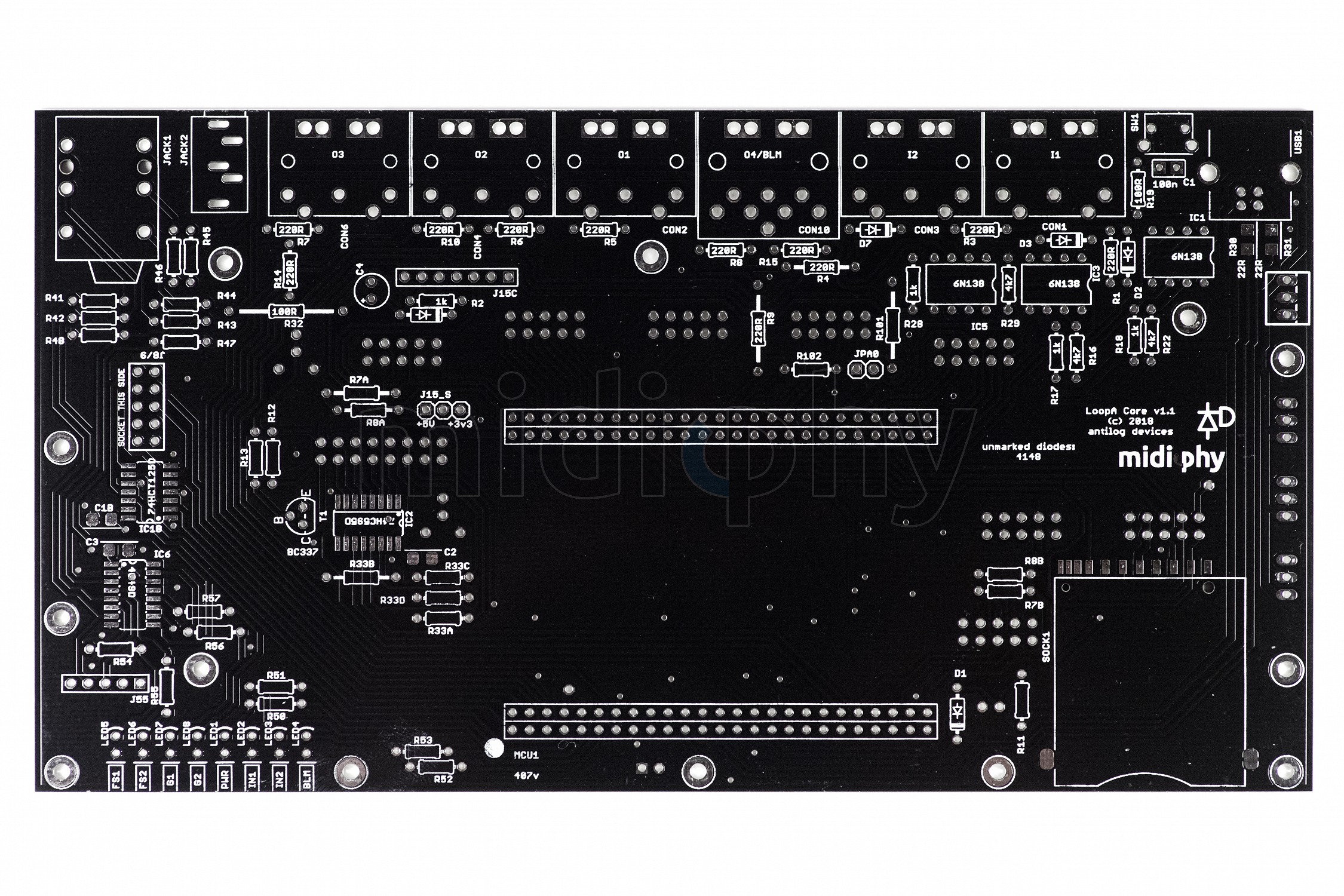

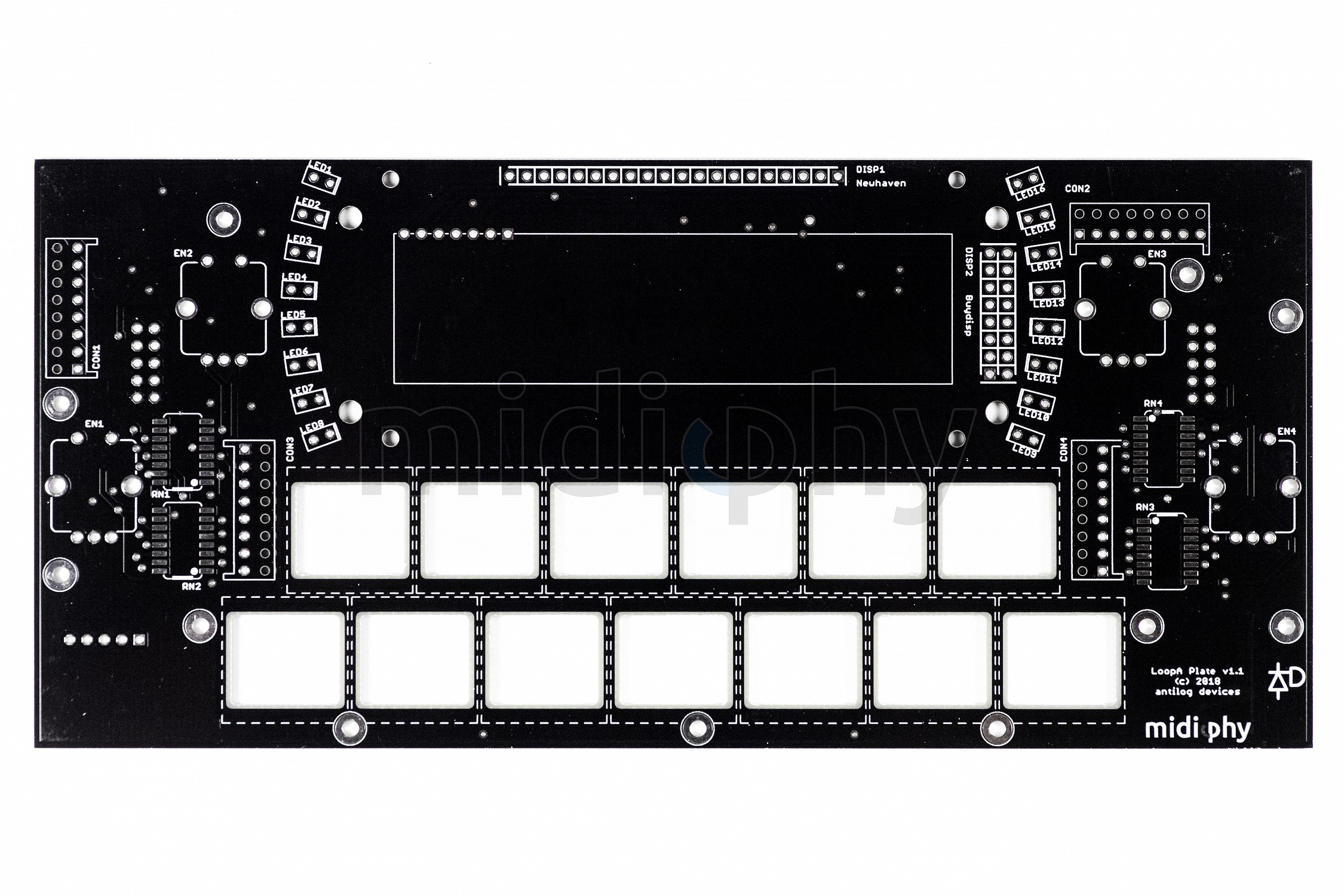

Hawkeye Posted September 11, 2018 Author Posted September 11, 2018 @duncandisorderly Thanks for your kind words, and yes, we are working on the LoopA. Even if the new v4+ has the first priority still at the moment, but it should hopefully all be done and settled in October/November. We now have the (hopefully) final PCBs waiting for validation. Also, we have slightly improved the acrylic case and added "interlocking" mechanisms to further clamp it down better (in the middle of the case), just as recommended by @Antichambre. The acrylic case should also not be expensive, somewhere in the range of 40-50€, so that this unit will be affordable. We're also open regarding new and exciting "uncommon" firmware features, that not every sequencer has, thanks for your suggestions! But let's get some initial units out, first :). Find a few PCB shots of the three to-be-stacked and hopefully final LoopA PCBs attached: LoopA Core PCB v1.1 - note the additional 6N138 optocoupler for a third MIDI IN (2 normal INs, one BLM) and the moved SD-Card slot that would open up an option for a nice "pro" metal case made my Adrian (with wooden sidepanels) :). But nothing confirmed, yet, just the acrylic variant for now. LoopA Base PCB v1.1, with improved interconnectors LoopA Plate PCB v1.1, with support for two different OLED manufacturers: Many greets and enjoy! Peter
Antichambre Posted September 11, 2018 Posted September 11, 2018 (edited) It seems you put CV/Gate Outputs :) Great! Add it in the Main features list, this is an important point. Edited September 11, 2018 by Antichambre
latigid on Posted September 11, 2018 Posted September 11, 2018 (edited) 1 hour ago, Antichambre said: It seems you put CV/Gate Outputs :) Great! Add it in the Main features list, this is an important point. Actually only inputs are supported, you'll need a converter to use CV/gate. In principle it could be done as all expansion headers are there. I don't think the software handles CV and there is not much push from our side to squeeze it into the current box. A bigger unit might work. On that point, this represents another Core with DIN MIDI onboard. We could consider other "stackable" add-ons for small synths or controllers. Edited September 11, 2018 by latigid on
Antichambre Posted September 11, 2018 Posted September 11, 2018 Yes of course it needs more than 5V power supply for CV purpose.

Hawkeye Posted November 13, 2019 Author Posted November 13, 2019 Update! :) Well, it has certainly taken a while, but the LoopA release should really be happening soon, now! The assembly video tutorial has been completely filmed (350 GB of 4k footage), and now "just" needs video editing and voiceover. The PCBs have been built a third time and the BOMs are now verified. Also, the launch software version 2.05 has been tested, tested again and then completed :). Many thanks to Andy for the huge amount of time he invested in this, from creating the PCBs to endless dicussions to finally proofreading the manual! And here it is - we've finished the LoopA user manual, describing all features and screens in 20+ pages, so you can have a glance what the unit will do - we hope you will like it: https://www.midiphy.com/files/468/midiphy_LoopA_manual_v205.pdf Of course, there are lots of future features/enhancements on the wishlist, but the current features will be "it" for the launch and we hope you also consider them to be nice! :) An (incomplete) list of new things since the last update: * named user instruments mapping to hardware MIDI ports/channels (e.g. you can now simply use "ANDROMED" instead of memorizing MIDI OUT1/CHN1) * a detailed setup page, allowing to configure global parameters * a new and optimized page switching UI, using a onehanded two-finger-gesture facilitating "haptic finger memory" for quick page switching * fully graphical menu/page icons * a dedicated shift button, allowing for direct mutes/unmutes from every menu screen (an often needed feature) * two powerful live performance modes (beatloop/transpose), switchable and directly mapped to a separate performance encoder * MIDI metronome support * live (re)quantized swing * note randomization/probabilities (visualized als "animated quantum note clouds" if the clip notes playback probability is less than 100% :)) * note freezing option after transformations (allows e.g. to "move" notes around a clip first, freeze and then "scale" their playback speed) * integrated context-sensitive help system explaining every feature of every screen ... and a few others :) Hope you enjoy! Please stay tuned, more coming soon! Best regards, Peter

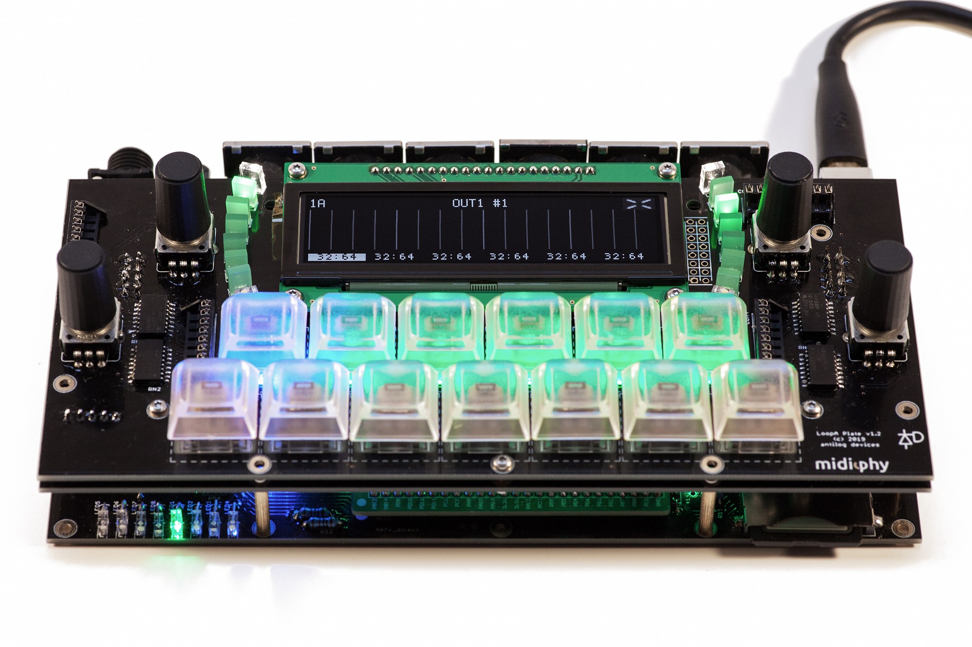

Hawkeye Posted November 30, 2019 Author Posted November 30, 2019 And, it's finally release-day, sorry for all the delays and thanks to everyone who helped! The LoopA is now publicly available in two variants, a caseless/barebones variant, and an acrylic case variant: https://www.midiphy.com/en/shop-details/139/69/caseless-loopa-essential-kithttps://www.midiphy.com/en/shop-details/139/65/loopa-acrylic-case-essential-kit Also, Adrian Hallik from Hallik Engineering is working on a new metal case, which should be available in early 2020. You can easily transplant the caseless LoopA to any case. Here is the full (2 hours +) video tutorial, all in all it should be a doable project and there are no IDC cables to build! :) And here are some impressions/photos of the kits and the final units - enjoy! :) Firmware releases and user manual/handbook documentation updates will always be posted/linked in the first posting/on top of this thread! Have a great weekend and hope you enjoy the LoopA! Best regards, Peter
