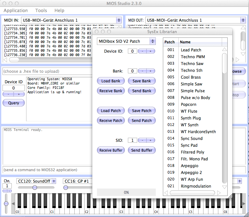

TK. Posted September 3, 2012 Author Report Share Posted September 3, 2012 A quick hack will be released soon: Background info: this Librarian was already on my agenda some months ago, but then I found Ctrlr and thought that it could make it obsolete. But the Ctrlr based "Program Manager" is far away from completion... Yesterday I spent some time to debug the panel restore issue in the current Ctrlr version (btw.: it's solved now, and meanwhile I would be able to release Ctrlr binaries by myself), by doing this I realized that if I would program a Librarian for MIOS Studio, I could later also integrate it into Ctrlr because both applications are based on Juce (I will ask Atom about this possibility once I've finished the MIOS Studio variant) So: the Librarian should be ready for use by end of this week - it will support MBSID V2 and MBFM V1, and maybe also some other MIDIbox apps. Best Regards, Thorsten. Quote Link to comment Share on other sites More sharing options...

TK. Posted September 6, 2012 Author Report Share Posted September 6, 2012 Thanks! :) There is some progress: patches can be moved around the bank. Insert/Delete is supported as well. Multi-Selections are possiblethere is now a "Transaction" and "Assembly" bank. The idea: the Assembly bank is a temporal storage which allows to compose a new bank from different .syx files or received dumps. Once it's ready, the Transaction bank can be completely cleared, the Assembly bank can be moved into the Transaction bank, and then stored into a new .syx file, and/or transfered to the MIDIboxpatch names can be modifiedsupport for MBSID V2, MBFM V1, MB808 and Waldorf Blofeld (just for my own purposes ;-)) Best Regards, Thorsten. Quote Link to comment Share on other sites More sharing options...

m00dawg Posted September 6, 2012 Report Share Posted September 6, 2012 there is now a "Transaction" and "Assembly" bank. The idea: the Assembly bank is a temporal storage which allows to compose a new bank from different .syx files or received dumps. Once it's ready, the Transaction bank can be completely cleared, the Assembly bank can be moved into the Transaction bank, and then stored into a new .syx file, and/or transfered to the MIDIbox That is an awesomely clever idea, TK! Very cool! Quote Link to comment Share on other sites More sharing options...
Hawkeye Posted September 7, 2012 Report Share Posted September 7, 2012 Great job on the integrated patch librarian! Thanks, TK.! It will really make archiving patches easier and it is good to see it MIOS Studio :) Many greets, Peter Quote Link to comment Share on other sites More sharing options...

TK. Posted September 8, 2012 Author Report Share Posted September 8, 2012 Thanks for the nice words! :) The librarian is now available in MIOS Studio 2.3.0 I hope that it works well at your side, I only tested it under MacOS 10.8 (Mountain Lion) Best Regards, Thorsten. Quote Link to comment Share on other sites More sharing options...
