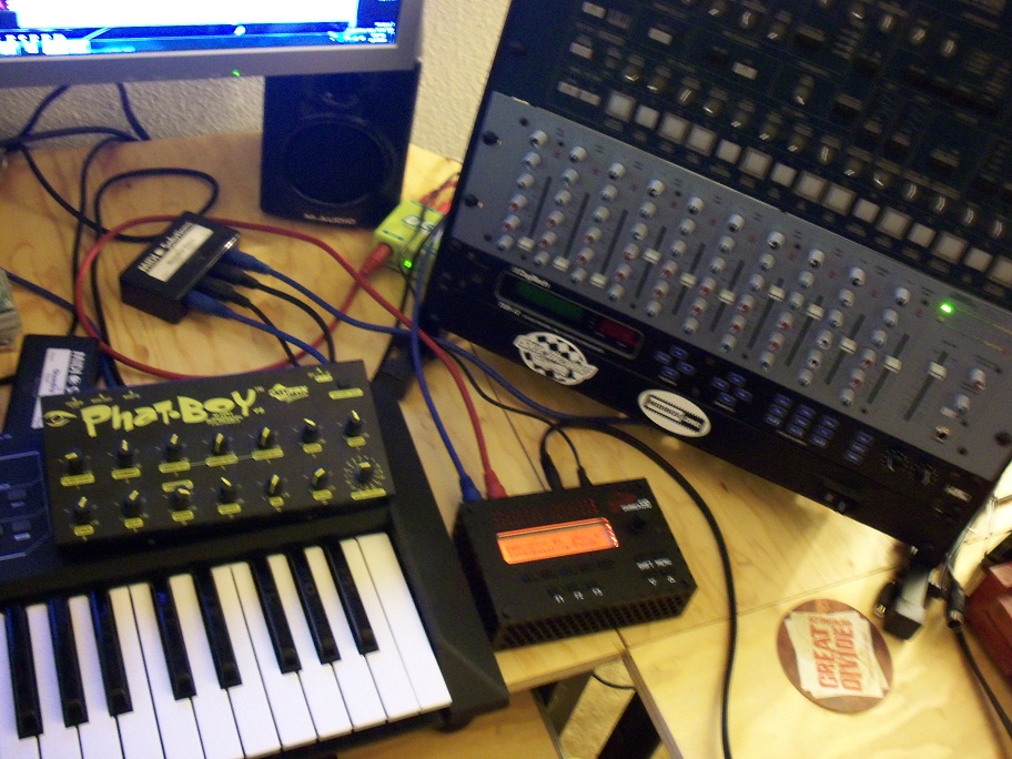

Labelwhore Posted December 8, 2009 Report Posted December 8, 2009 Do not eat this sammich! I just finished, time for some pics :) Also; I've been searching, but can't seem to find patch banks to download. Where are they hiding?
m00dawg Posted December 8, 2009 Report Posted December 8, 2009 Ooh that red looks nice for the Sammich! Patches are in the MB-SID download (off ucapps.de). Note that Wilba sent out specific firmware for that sammichSID, but you can still get the patches from the standard MB-SID package. TK's also asked for help creating an Arp-centric patch-set, which you can check out here: Though it still needs more user submissions, it might have some workable patches. And, of course, you can submit your own :)

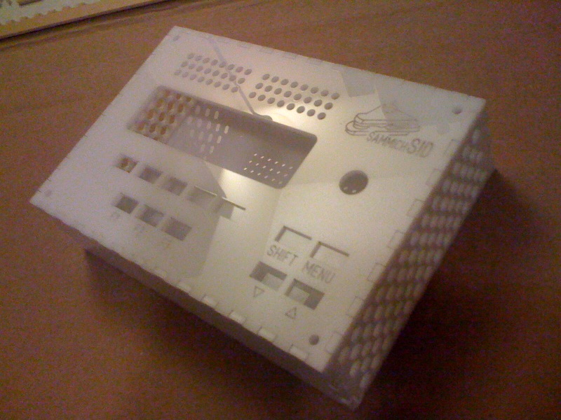

djthomaswhite Posted December 16, 2009 Report Posted December 16, 2009 Hi all, new to the list but not to diy. Glad to be here! Here is my limited edition white Sammich wrapper. I'm using orange LEDs and amber display. I also got some white button caps from digikey. Should look real nice when finished next to my white Access Virus and Whitewashed Voyager OS.I happen to have a couple extra cases I am willing to part with once I get this built. PM me if interested in a white case. Case is from Ponoko in 3mm White Acrylic. Looks really nice! Thomas www.naturalrhythmmusic.com/diy.html
